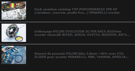

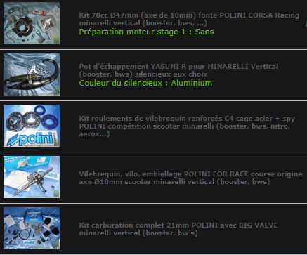

Salut. Je cherche à construire mon premier scooter. Il s'agit d'une Yamaha Zuma 1999 avec un moteur minarelli vertical. Je cherche des conseils sur ce qui est le mieux pour construire le cylindre Polini Corsa 70cc. C'est ce que j'ai collecté jusqu'à présent.
Hi. I'm looking to build my first scooter. It is a Yamaha Zuma 1999 with a vertical minarelli engine. I'm looking for advice on what is best to build the Polini Corsa 70cc cylinder.
This is what I have collected so far.
image.png.fdf7a691b63a92cd06cefcfa5ef1aaa0.pngimage.png.ed9d9d31f6932d0894c8ba9c531eac00.png
Any advice is welcome. Thank you
Tout conseil est le bienvenu. Je vous remercie

hi, Dell'Orto carburetor 21.5 phbg with a nozzle of 88, polini exhaust for race or yasuni c16, ignition key offset top perf, polini variator with roller of 4.8 gr see 5 gr, thrust spring and red clutch (malossi ) or red air filter foam malossi, if the biele has a lateral clearance it will be necessary to change the crankshaft by a reinforced one. and to make good use of all this, a secondary transmission in 14/41.
do not buy on rdd préparation, it is not a good site, not serious.
scootfast or mxs
